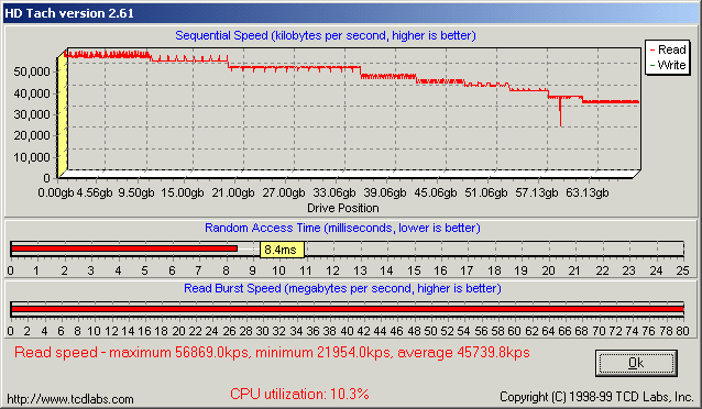

The HDTach results show that the average read speed for the whole drive is 45739.8kps, and random access time is 8.4ms. You can also see the high burst speed provided by the U160 interface.

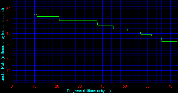

The STR graph above shows the sustained transfer rate of the drive for all areas of the platters in the drive. Starting strong at around 56MB, the drive finishes at around 33MB. Pretty Impressive!

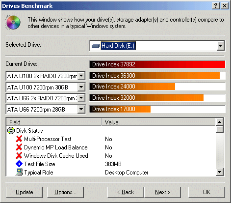

Sisoft Sandra gives a synthetic benchmark of the drive and displays its overall resulting score. I basically just throw this benchmark in to give an overall idea of where the Seagate ranks. The Sisoft suite has been known to give weird results sometimes, so I use it's results loosely.

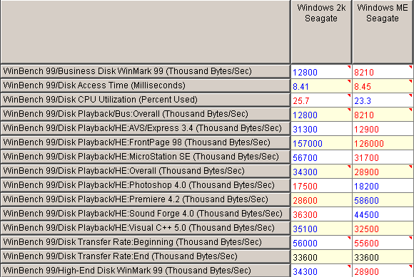

**FAT32 used for both OS's
For the Winbench scores I tested the drive in both Windows ME and Windows 2000 using FAT32. The Playback scores give more of a real-world example of how this drive performs when it comes to applications. Not suprising, the drive seemed to perform better in Windows 2000.
Overall the scores are pretty impressive.
