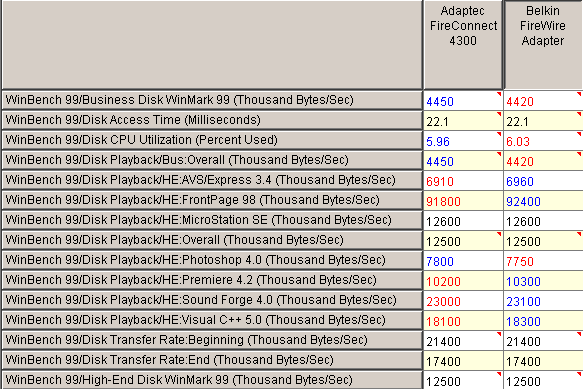

Unfortunately I was unable to locate a device or test that would utilize the full bandwidth of the FireWire bus. I did, however, run tests to determine the consistency in bandwidth between both cards. To do this I used the Maxtor 80GB FireWire External Storage.
I used Winbench 99's Disk Transfer Rate test to determine if there were any fluctuations in bandwidth consistency between the two FireWire cards when conducting transfers on the Maxtor FireWire drive. I also conducted six runs on each card of Sisoft Sandra's hard drive benchmarking tool and then averaged the results.

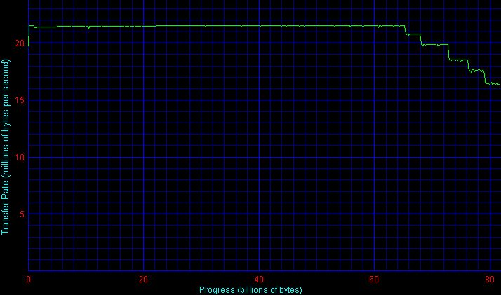

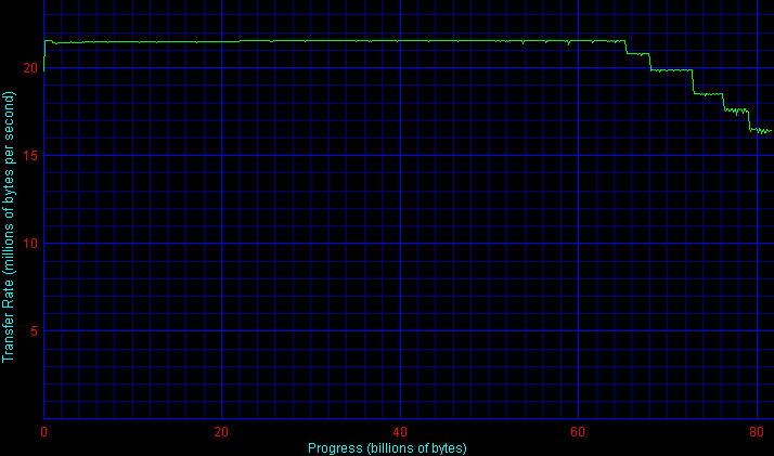

Winbench 99 DTR Comparison
(FireConnect 4300)
(Belkin FireWire Card)

Starting with the Winbench DTR comparison, it can be seen that the sustained transfer rates between the two are almost identical. There is only a very small discrepancy between them, not enough in my opinion to deem one better than the other.
In the Winbench disk playback results it can be seen that there is no consistent winner here either. The results fluctuate back and forth between the two with one adapter winning by only a very small amount.
