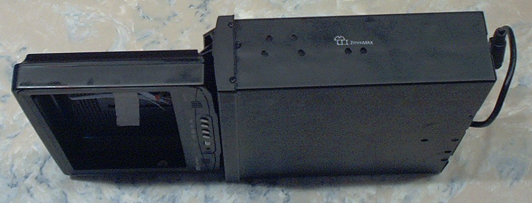

Upon receiving the product from Digital Worldwide, I took it out for inspection. The unit I received was completely black, and the casing on it was constructed completely of metal. Unfortunately, like those $1500 LCD receivers, this kit does not retract into the unit automatically by the touch of a button. The unit operates by employing an LCD mount which fits into the metal casing of the unit. The mount utilizes gear wheels on it to slide along a gear track. As you manually push the LCD into the receiver, it locks into a spring loaded clip in the back of the unit. Once locked in place, you simply push again on the LCD and the spring loaded clip releases the LCD so that it can be pulled out. The LCD mount features a spring on the back of it to help push the LCD out. While this may all be difficult to imagine, it should become clearer as you look at the pictures below.
